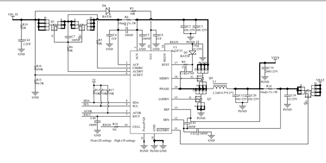

Could .you help to review the schematic of BQ24715?
Input voltage 20V, 2 cells Li battery, 2A charging current.
Hello Fabio,
I don't see any obvious issues with the schematic.
Christian.
The customer is using BQ24715 to charge two cells battery. 20V input voltage/2A.
But the temperature increase is larger than 50℃ of this chip.
What is the potential reason? It seems there is no place in the cheap which could consume so much power.
Hello Fabio,
Can you confirm that you followed the BQ24715 PCB layout guidelines:
Christian.
The customer have revised their layout from two layer to four layer.
Could you help to review the layout and give some improvements suggestions?

Hello Fabio,
I don't see any obvious issue with the PCB layout. We suggest mulitple copper layers to dissipate heat to reduce the case temperature without these extra layers we don't have any other ways to increase heat dissipation.
