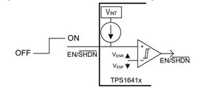

I quite lack UVLO function within TPS1641...intent to use it for 18V-30V powering where should be 15-16V UVLO.
Additionally UVLO should be with manual switch, both function should turn off/on output power.
UVLO circuit should withstand possible input transients...
Does anyone have any idea how to make it externally through pin EN?
There are some ways I've got as idea:
- zener diode with transistors -> this is easy but without hysteresis I need it around 1V.
- comparator with hysteresis -> quite complex but adjustable hysteresis
- supervisor circuit -> easy but I couln't find anything with sufficient hysteresis level
