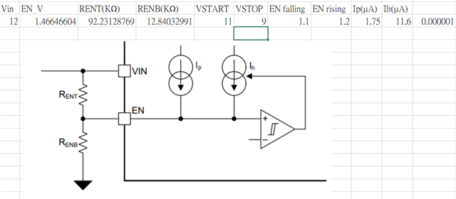

  • Hello David
    Thanks for explaining this part.
    1. Then I would like to ask you, assuming my configuration is as shown below, I can understand that when my VIN climbs to 11V, the Power ic will start to output?
    2.
    When designing UVLO, I only need to pay attention to the fact that the final partial voltage of EN should not be greater than 5.5V, right?
    When selecting a voltage dividing resistor, do you have any suggestions on what value should not be lower? KΩ?
    Can Ω grade ones be used?
    3.
    VIN also has a UVLO, but I saw that the Linear Regulator is controlled by EN_UVLO.
    So my understanding is that when my VIN exceeds VIN_UVLO, it still needs to exceed the EN_UVLO I set before the output will start?
    4.EN_UVLO See that Float can be set, will EN_UVLO have any effect at this time?
    Thank you for your reply.
    Guanming.
  • Guanming,
    Quick reply
    R1:   Your Ih needs adjusting.     Ih is 11.6uA - 1.75uA  = 9.85uA      Once the voltage on the enable pin is greater than 1.2V typ. (1.25V max)
    and after a 1ms delay the device will start switching the SW pin.  See figure 7-9 in datasheet page 31 for en to output voltage rising waveform.
    R2:   When designing the ena uvlo focus on the start voltage and stop voltage.  Once the resistors are selected, check the enable voltage level at the maximum input voltage in your system.
    R3:  Multiple states must be true for the device to starting switching, vin, en pin and vcc output uvlo must be true.
    The LDO turns on at a lower ena voltage, so the LDO regulator can power up and have a steady voltage before the device needs to start switching. When the VIN is greater than UVLO AND EN voltage greater than threshold and the VCC voltage greater than 3.4V (vcc uvlo) the device can switch.   If either VIN or EN uvlo  or VCC voltage is lower than thresholds, the device will not switch/ or stop switching.
    R4:  Not sure I understand,   if en pin is floating there are no resistors on enable to adjust vin start voltage and the internal en current source makes the voltage go greater than enable threshold when the input voltage is greater than the VIN uvlo.     Figure 7-9 to 7-15 show the different startup sequences.
