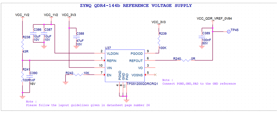

In my case, I'm only using reference input, and reference out the remaining pins, such as VLDOIN and VIN I'm not using. Should I connect VLDOIN in accordance with the data sheet and leave VIN NC,or else Shall I leave both the pins NC, which is the preferable option?

You will need to connect VIN for REFOUT to be available. VLDOIN doesn't appear to be necessary for REFOUT. Make sure the PGND (Thermal Pad) and GND pins are properly connected to GND reference.

Hello
Please look over this circuit once. We are not using the VTT supply, thus we kept the EN pin low and the VO and VOSNS as NC as per your advice.

Hello James steenbock,
Thank you for the response
1.Ok as I will reduce the VIN Capacitance
2.As per the QDR-IV,reference voltage is 0.84 that’s why we are keeping R241 as 100R and R238 as 43R.

You can still achieve 0.84V REFOUT voltage with higher resistance values. For example you could use R241 = 10k and R238 = ~4.286k. This would give you the proper ratio for 0.84V.
0.84V = 1.2V x [10k / (10k+ 4.286k)]
Also, make sure you are using at least 1% tolerance resistors.
I don't think there's an issue for the TPS51200 if you use lower resistor values but for your 1.2V source, lower current draw through the resistor divider to GND would be preferable.
