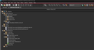

My customer would like to confirm TPSM33625 with PSpice for TI, but they could not.
I would be grateful if you could advise.
---Question
The PSpice Model of TPSM33625 cannot be executed on PSpice for TI.
Could you please let me know what to do.
Tool used: PSpice for TI 23.1-2024 S001 Windows SPB 64-bit Edition
After downloading the TPSM33625 Transient PSPice Model,
Open tpsm33625_trans.opj in SNVMCA6.ZIP with PSpice
File→Design Resources→\tpsm33625_trans.dsn→Startup→PAGE1
I displayed the circuit diagram using this procedure.

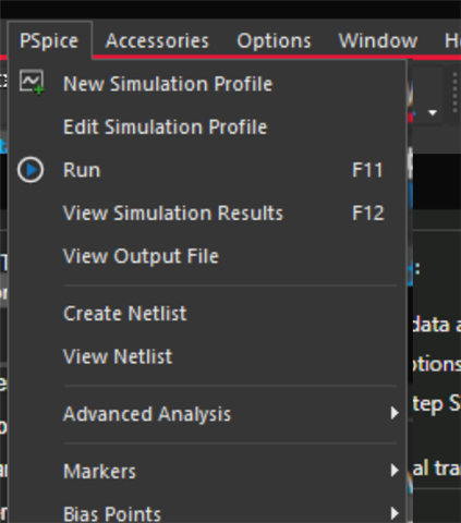

In TPSM33625, Run PSpice is grayed out and cannot be selected.
Please take a look at the attached screenshot.

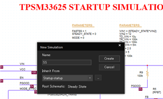

    It looks like that file doesn't come with a default simulation profile. They first gotta make one by clicking new simulation profile:
    Then maybe having it look something like this. Then they can run their simulation.
    Andrew

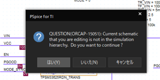

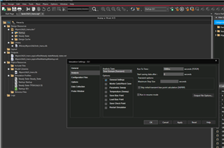

  • Hi Andrew,
    My customer and I followed your advice, but it still forced a shutdown.
    Please check the following and let me know what to do.
    1. Select new simulation profile and select Startup for Inherit From.
    2. Click OK on the screen that appears.
    3. Select RUN and the following popup will appear. Clicking Yes will force shut down Pspice.

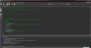

    4. After rebooting, press RUN and then Yes and the screen below will appear.
    WARNING(ORPSIM-15188): There are no devices in this circuit says, so something may not be recognized correctly.
    I appreciate your great help and cooperation.
    Shinichi

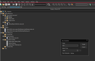

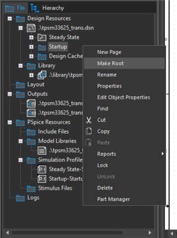

  • Hi Shinichi-san,
    Can you please try again, but make the startup schematic the root file before step one?
    Andrew
  • Hi Andrew,

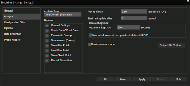

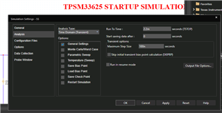

    I tried the simulation you suggested, but PSpice was still forced to shut down.
    made a root file
    then made anew simulation
    Simulation Settings
    the simulation button can click
    However, After clicking, the simulation was not executed and was force to shutdown.
    A kind of error message appeared, but I could not capture.
    Could you please advise what to do?
    Shinichi
