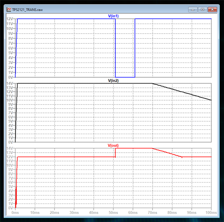

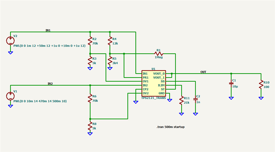

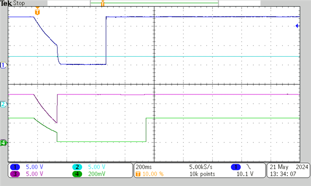

We're working on a design where TPS2121 seems like a good fit.
The problem we're facing is that IN1 can both be higher or lower than IN2.
Running from IN1 works fine and it switches to IN2 as it should.
Howeve if IN2 is higher voltage than IN1, it will not switch back to IN1 once IN1 is valid again.
Is there a way to force VOUT back to IN1?
