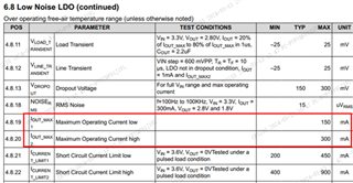

Hi PMIC team,
Could you please tell me the difference between maximum operating current low and maximum operating current high, thanks in advance!
Jack

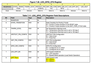

Hi Jack,
This is based on the LDO_IOUT bit setting - the lower limit setting corresponds to the lower max operating current.
