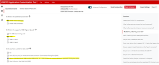

    For this application I recommend using TPS25751, this is a PD controller with a easy to use GUI to develop the PD configuration including the preferred data role. You can find more details on the device itself on its main product page (https://www.ti.com/product/TPS25751) or on the EVM user guide for GUI tutorials (https://www.ti.com/lit/ug/slvucp9a/slvucp9a.pdf?ts=1716434920746&ref_url=https%253A%252F%252Fwww.ti.com%252Fproduct%252FTPS25751)
    The TPS25751 GUI has a questionnaire page to select the system block diagram, highest power for source/sink, preferred power role, preferred data role, supported USB speed and other features. For your application all you have to do is set Question 4 (What is the preferred power role?), Question 5 (What is the supported USB Highest Speed?) and Question 6 (Do you have a preferred data role?) as shown below:
    What this does is when TPS25751 is connected to a PD capable far-end device, it will attempt to be a source as well as initiating a data role swap to become UFP (device). If TPS25751 ever connects as a sink, it will also try to become source by initiating a swap to source message with the connected port partner.
    Let me now if you have any further questions or concerns!

    After reading TPS25751 datasheet, my understanding is that I can configure it for my application through GUI tool which will generate binary image which will be programmed into the EEPROM. TPS25751 will read this configuration data every time it is powered on over I2C lines. Is my understanding correct ?
    If it is correct then how do i program EEPROM on my production board. Through TPS25751 EVM or from other external EEPROM programmers ?
    Can I use TPS25750 also as it looks similar to TPS25751 ?
    Is there any other total hardware solution available which does not require firmware programming ?
  • Hi BP,
    Yes that is correct. Whenever TPS25751 boots up it will read and load the PD configuration from the EEPROM. The PD configuration image is generated as a full flash binary through the GUI. It is also possible the load the PD configuration using an External Controller via the I2C target line on TPS25751. More details on this flashing method can be found in the Technical Reference Manual: https://www.ti.com/lit/pdf/slvucr8
    You will need to use an external EEPROM programmer to flash the EEPROM. For testing/validation we typically use the Aardvark adapter for flashing the EEPROM (https://www.totalphase.com/products/aardvark-i2cspi/?GA_network=g&GA_device=c&GA_campaign=19671691348&GA_adgroup=149567408521&GA_target=&GA_placement=&GA_creative=647807793976&GA_extension=&GA_keyword=totalphase%20aardvark&GA_loc_physical_ms=9026941&GA_landingpage=https://www.totalphase.com/products/aardvark-i2cspi/&ga_keyword_match=e&ga_ad_position=&gad_source=1&gclid=EAIaIQobChMIpbGOmYCnhgMVaDjUAR3-xQ2pEAAYASAAEgIeAPD_BwE
    TPS25750 is the predecessor to TPS25751, for new designs we recommend using TPS25751. For more details on migrating to TPS25751 please refer to this FAQ page: https://e2e.ti.com/support/power-management-group/power-management/f/power-management-forum/1346998/faq-tps25751-migrating-from-the-tps25750-to-the-tps25751
    Our PD controllers require firmware programming based on the user's application, that way you can set what USB speed the PD will advertise, tying different events to GPIO to control other peripherals, etc.
