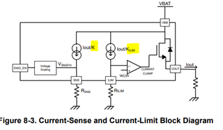

Hi team,
Are "K" and "KLIM" shown in "Figure 8-3" corresponding to "KSNS" and "KCL" in "6.5 Electrical Characteristics" respectively?
Ochi
Hi team,
Ochi
Hi Ochi-san,
Yes K and KLIM correspond to KSNS and KCL respectively.
