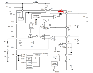

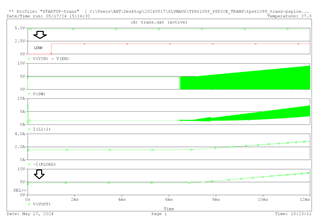

our client use TPS61088-Q1 of Pspice model to simulation, and we find EN pin pull low to GND but output have a voltage?
schematic:
20240517-slvmau6a Add EN 100K to gnd-Schematic (003).pdf
waveform:
20240517-slvmau6a Add EN 100K to gnd-Simulation (001).pdf

  • Hi Lawrence,
    The device is not true load disconnected.
    When EN is low, the body diode of high side MOS can conduct Vin to Vout.
    If you need a boost with true disconnect, please refer to TPS61378-Q1 or TPS61178.
