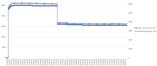

We have a battery that, when charged to 100% and then left to rest, gave us a SOC jump from 99 to 65 for example.
To fix this problem, we changed RELAC_JUMP_OK to 0. After this change, we haven't seen any more SOC jump at rest
Could be have any problem by changing this parametre?
Our equipment is at rest, an average of 12hours per day, and the rest of the time it makes movements from 2A every 2minutes.
