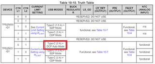

Customers want to know how large the current is when TPS25830A-Q1 cannot support DCP AUTO.
In my understanding, when apple device connect the charger with a type-C connector, the device cannot support Type-C protocol. So it can only use BC1.2 CDP, which is 5V/1.5A.
If they use TPS25831-Q1, it has DCP AUTO feature. So the device can charge with 5V/2.4A. Right?
Besides, if the apple device is IPHONE15PRO, which has full function type-c connector, it can charge with 5V/3A(type-C protocol), right?
