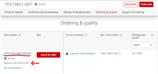

What is the difference between model Part number TPS73801MDCQPSEP and V62/18616-01XE-T ?
They both appear to have the same functionality.
If there is a reason for the difference in the model numbers, please let me know.
They are the same part. TPS73801MDCQPSEP is the Orderable Part Number assigned by TI and V62/18616-01XE-T is the VID number from the DLA.
