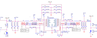

We are having a strange issue in our application.
One of the load device in our application system connected from 1V8 on rail 2 is drawing very high current (it is getting hot beyond 100degC on the thermal pad). However we do  not see the OCP trigger happening.
Please see the attached schematic for the reference.
Also we have tried to simulate this scenario on the benchtop level on the same PCBA - when the load current goes beyond 3.3A, the OCP triggers and the PMIC shuts off.
Our doubt is why doesn't this happen in fault state when a load device latches and sinks more current?

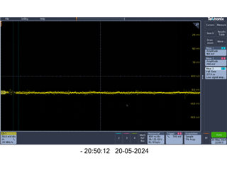

ac coupling 1v8 out

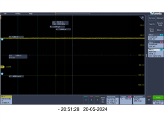

DC coupling 1V8 out

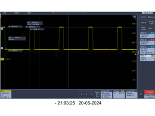

Vsw switching voltage on 1V8 rail

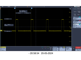

VBST on 1V8 rail.
