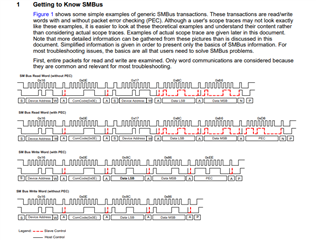

Looking to read and write data to the BQ40z50 using MCP2221-based system /SMBus command manipulation; tried the below with no joy.
-smbw=1 -slave8=0x0B -register=0x1f -pec=on-speed= 100000
-smbw=1 -slave8=17 -register=44,1f -pec=on-speed= 100000
Derived from the following configuration rules.
smbR=<bytes to read> slave<8|7>=<slave address> register=<value> [pec=<on|off>] [speed=<communication speed] [f=<file path>]

All combinations we have tried return Error 18 Timeout, can anyone support?
