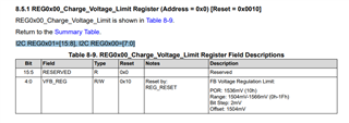

    i attached below the BQ25756 Register address,

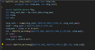

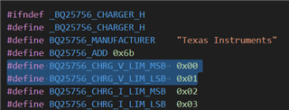

    Actually my doubt is, Charge Voltage Limit register address is 0x00 next address is 0x02  so there is no address called 0x01 am i right ? because the reason i'm saying this is see below:
    in this project "bq25756_charger.h" , see the below sippet they added the address like charger voltage limit msb - 0x00 and charger voltage limit msb - 0x01
    and the below picture the write value msb and lsb charge voltage limit
    and my doubt is why split msb and lsb the address of set voltage limit is 0x00 in datasheet but here 0x01 also is in so the reason ?
  • Hello Sankar,
    My understanding is that the Charge Voltage Limit register is a 16 bit register at address 0x00 and also takes up the address space of 0x01 as well. Let me know if that helps.
    Ethan Galloway
  • ok fine, then i have another doubt,
    in the above image, I2C REG0x01=[15:8] ---> this is MSB & address is 0x01 , and I2C REG0x00=[7:0] ---> this is LSB & address is 0x00, but the code you have provided below, mentioned MSB address is 0x00 and LSB address is 0x01 , what's the reason?
  • Hello Sankar,
    It looks like the driver file is written to be big endian. In big endian, the most significant byte (or largest) is stored first and read first.
    For the BQ25756, this really doesn't matter though. The only thing that matters is writing the right bits to REG0x01 [4:0] to set the FB voltage.
    Ethan Galloway
