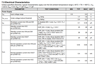

What is the quiescent current of this device?

Hi Kei,
Please refer the below figure and you can find it in datasheet:
