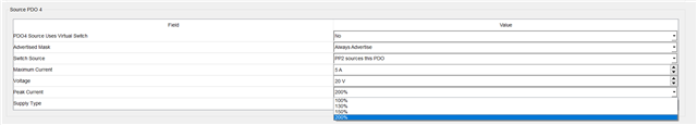

Our PDO setting in source:PDO 5V/3A,9V/3A,15V/3A,20V/5A
For our thermal&power policy,we need to switch the Source PDO from 100W(20V/5A)to 65W(20V/3.25A) through external MCU(connect to PD I2C2) in some scenarios .

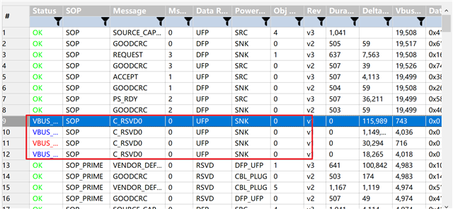

But VBUS will drop,and PD will reconnect.failed log is as bellow.
Do you know why VBUS drop and PD reconnect when report the source PDO again?
