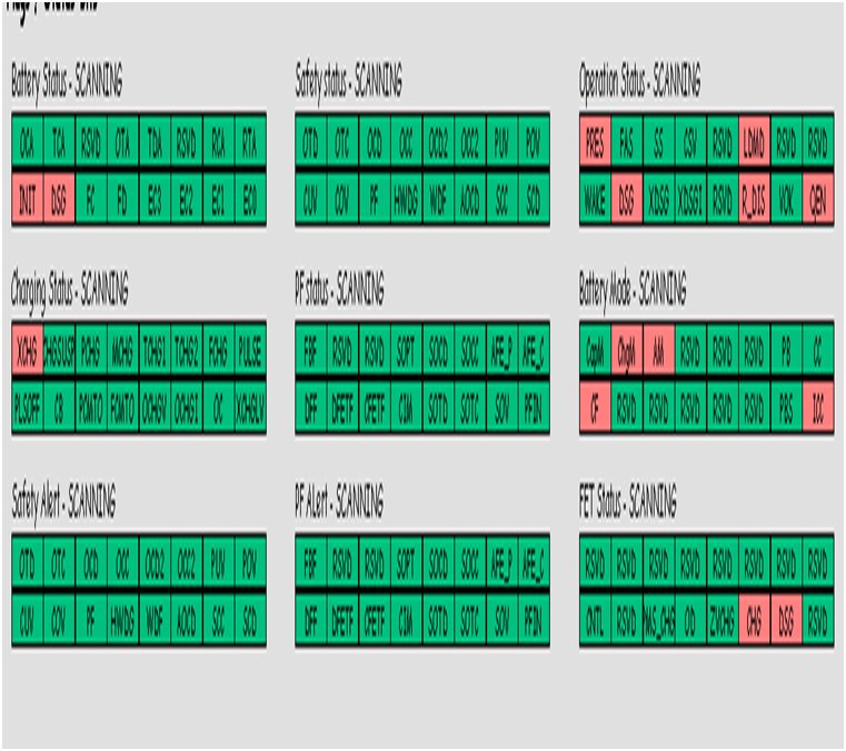

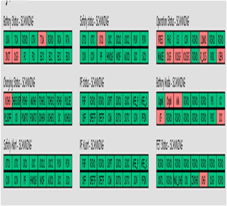

  • Hi Jason,
    As I discussed earlier I have problem in current recovery during discharge.
    I set my OC 1st tier dsg current -> 2000mA
     DSG Current Recovery -> 200ma
    Sense resistor -> 10 mohm
    1. I put load across Pack+ & Pack- & set load current greater than 2A.After this my DSG fet gets open & following was reading of registers:
    2. After that my current reduces to zero because dsg fet gets open, but I kept my load resistor connected to it. After that when avg. current falls below dsg recovery current for more than "Current Recovery Timer", my dsg fet gets back on. As you can see below
    But as told earlier, I kept my load connected to it. Now as you can both chg & dsg fet are on, then current should start again. But it do not get start again & even there is no voltage across PACK+ & PACK-, inspite of fact that both fets are on.
    But if I remove load & reconnect it again, current starts & voltage appears across output. I don't understand why this happens.Kindly help.

  • Deepak,
    Can you send me a log file showing this? That would greatly help me to figure out what the issue is.
    Jason

  • Deepak,
    It looks like Max Error is still set to 100 which happens when there hasn't been a valid learning cycle yet. Have you done this to your pack? Or are you using a supply just for bench testing? What are you using to charge with?
    Jason

  • Can you measure the gate to source voltage of the FETs to make sure they are really on? Current should flow if the load is connected and the FETs are on.
    Jason
  • Hi Jason,
    When OCD gets set, DSG fet gets off & voltage at gate pin of DSG fet is zero. After Current Recovery Timer, DSG fet gets on in its internal memory(i.e it gets set in SBS data which can be read), but actually in hardware voltage at gate pin is still zero.
    Regret for the delay in response.
