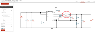

We must have a negative power supply of -15V.
The load is between 250 and 450mA with an input voltage of 24V.
The input voltage can be variering between 20 and 30V.
The switching freq is 400Khz
The design is based on the application note snva856b: https://www.ti.com/lit/pdf/snva856
At first can we using the LM38020 as an inverting convertor?
So not, which regulator we can use than?
So, yes
The calculation of the inductor is around the 200µH follow the application note.
If we use this value we will blow up the regulator due to over temperature.
what could be the reason for this?
Only when we reduce the inductance to 56 or 68µH it works better, but the regulator is still quite hot  (70°C).
How we should calculate than the inductor value?
  • Hi GBDH,
    Yes, you can use the LMR38020 as a negative converter.
    Can you provide the schematic as well as the part numbers of the different inductors you are using?
    Richard

  • Dear,
    The thermal pad, see EP pin in the schema, is connected to the output and not to the GND. It's a negative power supply.
    Is this correct?
    You say there is a dissipation of 1W, how did you calculate this and how can we solve this so that we have less power loss?
    What is the correct formula we should use for the inverse power supply regarding the inductor value calculation?

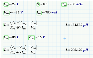

  • Dear,
    Yes the EP pin is connected to the output on a very large plane
    I think the core problem is how to calculate the inductor.
    On page 20 section 9.2.2.4 in the datasheet we can find the formula for the inductor.
    When we use the equation 10, the result is that we must use an inductor of 202µH for our application
    Even when we use your Webbench power designer tool, we become another inductor value between 56 and 68µH.  (39V used as Vin)
    ps: K = inductor ripple current factor
    Can you please provide us with the correct correct formula for the calculation of the inductor.
    Or if the equation from the datasheet is correct which values we should to use then.
  • Hi GBDH,
    The equation you are using is for a buck converter. In your case since you are using an IBB, you should follow this equation. Other components calculated for the IBB topology are shown here:
    Richard

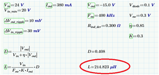

  • Dear,
    Sorry i hope that you understand that there is something wrong here.
    Please explain us exactly now why there is so a big different with the inductor coming out of the giving formula and the inductor calculated by the "Web Bench power designer"
    The formula give for the inductor 214µH and the "Web Bench power designer" give an inductor of 39µH  (factor of 5.5 lower)
    If we using the inductor of 220µH on the evaluation kit, it blow up the LMR38020 after 10 sec.
    An inductor of 39µH works better, but the LMR38020 has a to high temperature.
    So explain us now why the "Web Bench power designer" calculate an inductor of 39µH and with the provided formula we having a result of 214µH.
  • Hi GBDH,
    Looks like the webench power designer is calculating based off of the maximum current of the device, which is 2A. You may see further clarification here:
    If you need extra thermal dissipation, you may need to increase the copper heat sink area.
    Richard
  • Dear,
    It doesn't look like that the inductor is calculated for a 2A load
    On the WebBench Designer we become the follow inductor values with the same input voltages (20 to 30V) but with various output currents:
    - Iout = 0.38A  inductor of 47µH,  calculated by the formula 98µH
    - Iout = 0.5A    inductor of 47µH,  calculated by the formula 75µH
    - Iout = 1.0A    inductor of 47µH,  calculated by the formula 37µH
    - Iout = 1.5A    inductor of 33µH,  calculated by the formula 25µH
    - Iout = 2A       inductor of  27µH,  calculated by the formula 18µH
    ( first inductor value comes from the Wenbench and the second we had calculated)
    So give us a better explanation of how we must choose the inductor value.
  • Hi GBDH,
    The webench designer is meant for a first-pass design and so there is some limitation to the model.
    I suspect there is possibly some variation due to the inductor ripple factor and variation in the input voltage, which can usually range from 0.2 to 0.4.
    Based off the above formula you had, for 2A load, 100% efficiency, K = 0.4, VIN = 24V, I get around 28uH, which is close to the Webench value.
    Richard
