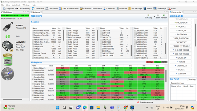

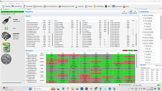

When trying to charge my battery pack i realised that it was not charging properly
after observing battery in BQstudio i noticed that the charge current was <10mA
what could be the potential cause here ?
i've attached BQstudio screenshot showing pack settings

  • Hi Jonathan,
    At the top of the Bit Register section of the screenshot, can you please ensure that the FETs are being enabled (using the FET_EN command) and that the gauge is in Charge Mode?
    Can you also please confirm that the charge current being passed is greater than the Charge Current Threshold?

    1. Is there another way of identifying "charge mode" apart from looking at the charge current fuel gauge & the current/average current register ?
    2. The FET is enabled cause the Flag is RED correct?
    3. What's the definition of "charge current threshold "??,this value is 50mA

  • Hi Jonathan,
    1. When charging has begun, the DSG bit that is seen red above should be cleared and turn green.
    2. Yes, FET_EN being red does indicate that it is enabled.
    3. Charge Current Threshold is the minimum current threshold needed for the gauge to enter charging mode. With the values above, the gauge will need to see a current greater then 50mA for at least 1s to enter charge mode. This current is measured by the sense resistor attached to SRN and SRP.
    Can you please tell me more about how charging is being attempted such as how much current is being put on the pack connection?

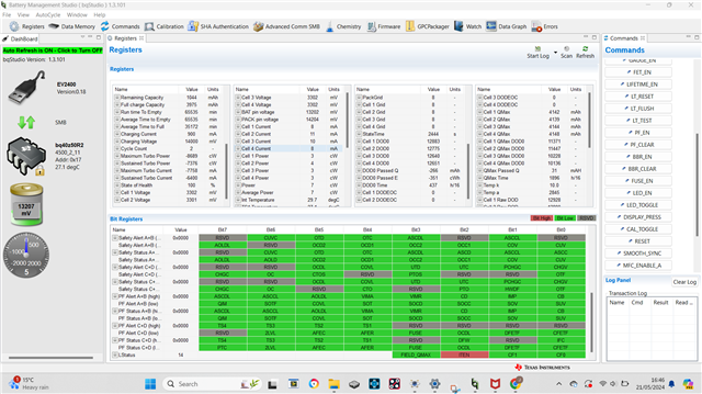

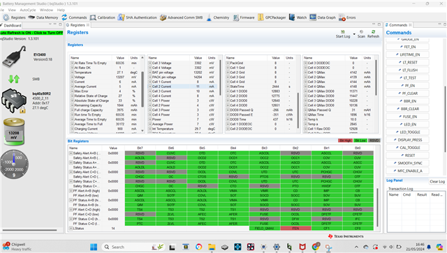

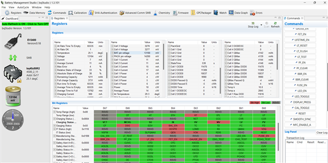

  • Hi Anthony,
    1.on that screenshot the charge current is about 7mA and the “DSG” bit is not turning Green Ofcourse you’ve explained this ,as this is below the min charging threshold of 50mA
    2.what does it mean if the “FET_EN” is enabled but the pack is not charging ?
    3.our pack is seeing no more than 30mA ,so definitely below charge current threshold!!!

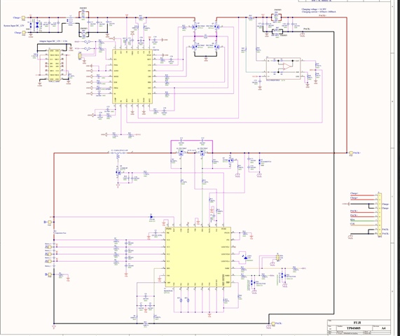

    **Our pack receives charge by two ways** ,
    • first way is charge input via USB-C connector
    • second way is by applying power directly to Pack+ and pack-
    Here's schematic for your reference:

  • Hi Jonathan,
    Enabling FET_EN allows the gauge to control the CHG FET and DSG FET based on the current being read from the sense resistor. If FET_EN is enabled and the read current is greater then the Chg Current Threshold, then Charge Mode will be entered.
    If the pack is seeing no more then 30mA, then you can reduce the Chg Current Threshold to allow it to enter charge mode.

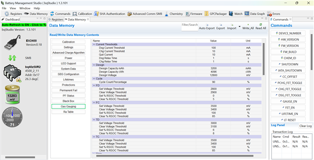

  • Hi Anthony,
    1.where can I find a document that explains each of the bit Registers flag such as GAUGE_EN,LED_EN,PF_EN,FET_EN etc…
    a document that can explain each function and how to control them
    2.how do I change the minimum charge current threshold value settings, do I need manufacturing access?
    Jonathan Kabangu
  • Hi Jonathan,
    The bq40z50-R2 TRM has the necessary information on the bit register flags and how to control them:
    https://www.ti.com/lit/pdf/sluubk0
    2. Changing the Charge Current Threshold can be done by finding its parameter in Data Memory and clicking the value, which should allow it to be altered, and changing it. Please ensure that it is written back to the gauge and the gauge is unsealed when this is being attempted.
    Anthony Baldino
  • “Changing the Charge Current Threshold can be done by finding its parameter in Data Memory and clicking the value, which should allow it to be altered, and changing it. Please ensure that it is written back to the gauge and the gauge is unsealed when this is being attempted.“
    1.how do I ensure it’s written to the gauge ? How do I confirm this change is applied?
    2.i have both “unsealed” and “unsealed for full access “ access ,which one of the two will enable me to make the change and write it to the gauge ?
    Jonathan Kabangu
  • Hi Jonathan,
    1. An easy way to check after pressing Write All, is to press Read All to make sure the same value is read out. You can also check by power cycling the gauge and ensuring the same changes have been made.
    2. I would use Unsealed Full Access for this.

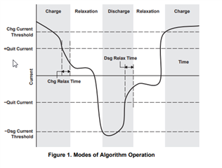

    Your understanding is correct, the current must be below the quit current for the gauge to enter relax mode. However, the gauge needs to clear the dV/dt condition when entering relax before calculations are made, where the resting voltage of the cell must not change by more then 4uV per second. That will determine when the gauge is truly in relax and making calculations.
    Our device is always housed inside the unit thus meaning that it's always discharging to the system ,when a voltage of >12.4V is seen then it begins charging,does this mean that our system never enters relax then?
    Yes, if there is always a current being applied to the cell, the gauge will never enter relax. This can cause issues since it will not allow for the necessary calculations to be made.

    This is photos of me altering the charge current to <10mA, as per your definition this is the minimum charge current that needs to be seen for the gauge to enable charging, even after doing this as you can charge current was <100mA, not sure why
    Jonathan Kabangu
  • Hi Jonathan,
    JK:if these batteries need quit current of <10mA in charge or discharge to enter relax, how can we ever achieve this if our charge current is above 800mA in charge or -200mA in discharge in operation?
    Even if the thresholds are changed to allow the gauge to enter relax at a higher current, the cell will never truly enter relax until the dV/dt condition is cleared, which will not clear until there is a minimal to no current being applied to the gauge. Is there no way in this application that a rest period can be applied?
    I would not recommend changing the charge current to under 10mA since this will not change the performance of the gauge since the present charging current is 800mA. However, if the value cannot be changed, can you please tell me more about how you are going about altering this value?

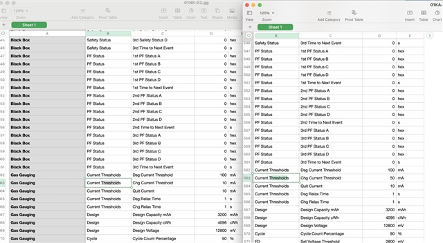

    For each of the two packs (functioning and non functioning), is it possible to send the .gg file of both so I can take a look to see what might be holding the charge up?

    Regarding the non-functioning pack, I found something odd in the .gg file where there are two DSG Current Thresholds and no CHG Current Threshold:
    Was there any alterations done to this .gg file before being sent or was this how it was pulled?

    2.i did alteration as you told me to change the original 50mA to something less like 10mA
    funny enough the settings looks normal on my side
    see screenshot:
    not sure what's happening here?

    Just to confirm, this was pulled from the faulty pack correct? If this has been corrected now, can you please send us a new .gg file so we can look through it again?

    2.Just to confirm, this was pulled from the faulty pack correct? If this has been corrected now, can you please send us a new .gg file so we can look through it again?
    01KA-02:2450.01KA-02.gg.csv
    (faulty Pack)01NK-02:2450.01NK-02.gg.csv
    Here's a picture showing each pack's gg file side by side and it does not show the 2 chg threshold:
    please check again and update me on your findings

    Anthony will be out town for a while, but I can continue to support you.
    I checked the gg file and see that Chg current Threshold was changed to 10mA for the 01NK-02 gg file. Now I would also recommend changing the Quit Current Threshold value to something smaller than 10mA since Quit Current Threshold needs to be less than Chg Current Threshold. Quit Current Threshold can be set to 5mA.

    If you look at the screenshot above you'll see the Pack charging at the same time the REST & CB  flag is also raised, is this a normal occurrence or is this bad for the battery?
    Jonathan Kabangu

    • relax is the mode the pack enters once quit current is met once charging or discharging is removed?
    • in the above comments you mentioned we enter relax after 30 minutes?, the documentation says:
    A relaxed state is achieved if the battery voltage has a dV/dt of < 4 μV/s. Typically, it
    takes 2 hours in a charged state and 5 hours in a discharged state to ensure that the dV/dt condition is
    satisfied. If 5 hours is exceeded, a reading is taken even if the dV/dt condition was not satisfied. The
    GaugingStatus()[REST] flag is set when a valid OCV reading occurs.
    • so does this mean we possibly have to wait 5 hours (from discharge). or 2 (from charge) to start balancing?
