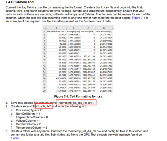

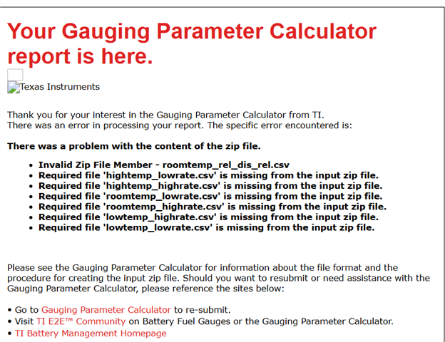

May I ask why the following errors appear in the document after I finish the room temperature cycle and upload the data according to the requirements of the document to GPC?  I have checked and uploaded the data in full accordance with the requirements.
    There are probably hidden characters in the config.txt file that is causing this error. I have an example of what these hidden characters looks like. I would recommend opening the file in a binary editor like Notepad++
