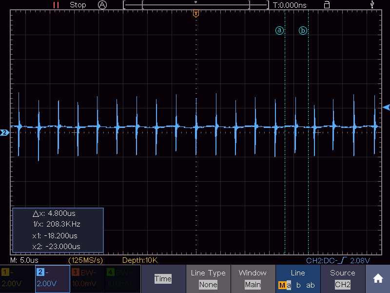

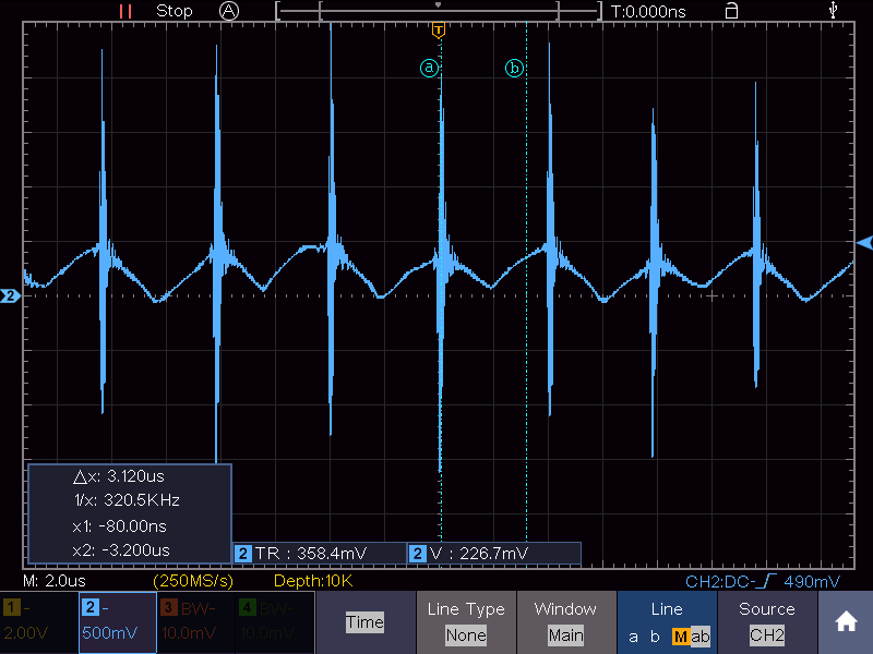

    Is it because of the noise in the feedback current sense signals??
     I_OUT (output current feedback)
     IPS (resonant current signal)
    Pratik
  • It seems the output still exists, just GUI is not communicating. I think the noise causes the communication failure. You can make the cable farther away from the noise source.
  • Hello Sean,
    I have tried it. But it does not seem to resolve the GUI communication issue.
    Further query, as the above feedback signals captured (I_OUT and IPS) are noisy, does it have something to do with the closed compensation parameters? Because, the output voltage decreases with increase in load.
    I mean to say whether the noise is the primary cause of improper 12V regulation, or it is because of the the improper compensation parameters?
    Pratik
