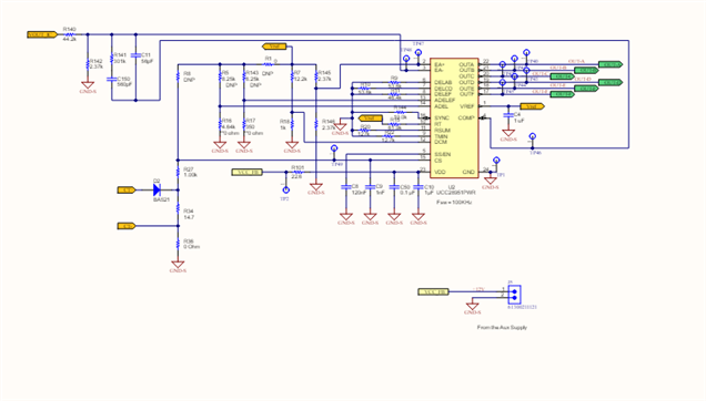

PSFB_Sch_Plant.pdfPSFB_Sch_Ctrl.pdf

    I reviewed the schematic and everything seems to be functionally correct.

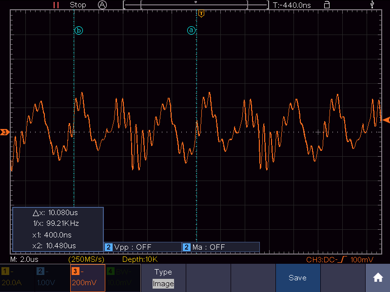

    The current sense signal probed at CS pin of IC through a normal test point pin is more distorted than expected and going below ground.
    Is this happening due to Layout as the current sense circuit is looking good to me?

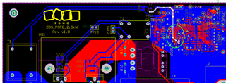

    (As Highlighted with green circle) I doubt if the CS signal crossing from below the OUT signals is distorting the CS signal?

    The CS signal should never go below ground.  R34 should always be above ground.  Diode D2 prevents current from going in the reverse direction.
    It could be a layout issue.  There may an issue with how R34 is referenced to the secondary ground.  You might want to check your return path to secondary ground.
    If your scope probe is not reference it could distort the signal.  I just want to double check that your scope probe is reference to the secondary ground.  You should be able to connect it to TP1.

    As you mentioned this might be due to layout issue, in this layout what changes about the CS signal do you suggest to eliminate the issue.

    Your current sense signal should not go below ground.  I have put your schematic and could you show me how there is a negative current that goes through R34 to developed to develop the negative current sense signal.  This is why I thought you had a probing issue.
    You should double check your probe ground.  If it is not that then there is most likely something wrong with your layout, schematic and/or build.
    The CS signal should not go below ground.
    The UCC28950 data sheet does give recommendations on layout that you may find helpful as well.  Please note that there is a 600 W reference design that uses the UCC28950 that has a proven layout.  You can find it at the following link.  You can use it to compare it to your layout.
