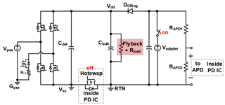

we want to use the dual input function, and also use the APD pin for the auxiliary power detect input, but we don't the LEDs of T2P & APDO to light up.
can we pull the DEN pin to GND? have any risk? or any suggestion to us? thanks.
  • Hi Tommy,
    I am wondering how you configure the dual input. Is it PoE PD + 48V DC adapter?
    T2P and APDO are output pins, you can leave them open and it won't influence the APD's function. You can add a resistor divider on the DC adapter input side, when APD is high the PD's internal hotswap will be turned off to let the DC adapter has a higher priority.
    Pulling DEN to VSS will force the PD to off too. But it normally need an optcoupler since VSS will be disconnected to RTN after hotswap is off. If your adapter refers to RTN, using APD is recommended.
