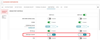

  • Hello Phillip,
    VBUS will always default to 5V for non-PD Type-C devices. The non-PD Type-C current can either be configured to 1.5A or 3A via the GUI's "USB PORT(S)" tab (see image below).
