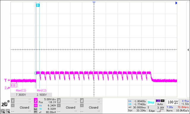

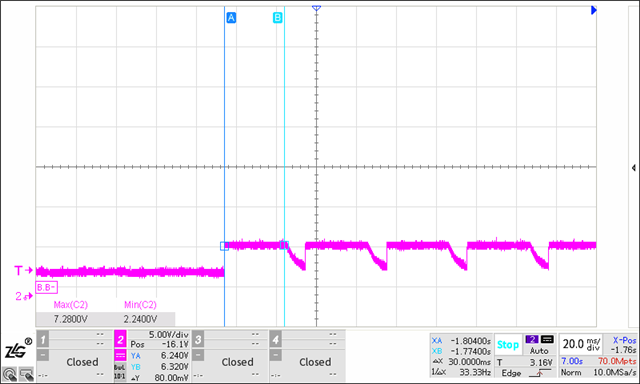

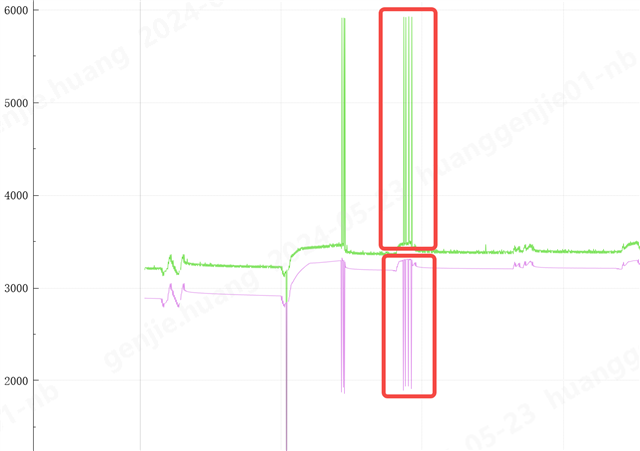

      We have used your company's BQ76942 chip, but encountered an issue. During the battery charging process, we found a symmetrical voltage jump between CELL1 and CELL2 displayed on the computer(Figure 1). Subsequently, we captured the voltage of the battery cell using an oscilloscope and found that the period of voltage jump of the battery cell was consistent with that when the battery was balanced(Figure 2-4)    .
As far as I know, corresponding cell sampling should not be performed during battery balancing. We want to know the reason for this situation? How to solve it?Looking forward to your reply!

  • Hello GJ,
    Looking back at this, I think I misunderstood your question at first!
    Is it possible to check the connection to CELL1? If there is not a good connection between the cell and the BMS board then this could increase the resistance in the cell path, which could potentially cause what is shown in the first image you showed. This image looks very similar to what an Open-Wire condition would look like, which could happen with high input resistances due to loose connections.
