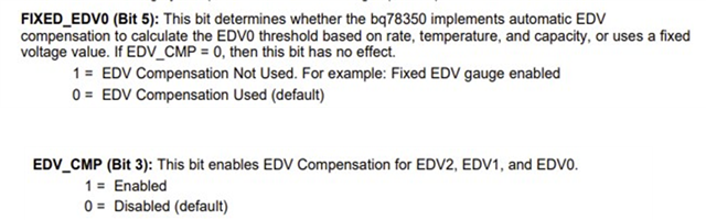

1) what actuall setting are being applied, when we EDV_CMP and FIXED_EDV0 bits set to zero, which are default settings?
EDV_CMP FIXED_EDV0  Applied Setting
0 0 ?
0 1 ?
1 0 Compensation (CEDV)
1 1 FIXED_EDV0

  • 1:The gauge will then use the following voltage thresholds for SOC:
    EDV2: SOC forced to 7% (bat low % - this can be changed to another %)
    EDV1: SOC forced to 3%
    EDV0: SOC forced to 0%
    It will not adjust (compensate for load and temperature) EDVx and use the values for EDV2/1/0 stored in the configuration.
