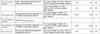

    2. What is the accuracy of the GPIO ADC pins in 25 deg and in temp?
    We provide the following for -40C to 125C in the electrical characteristics section of the BQ79718 datasheet:
