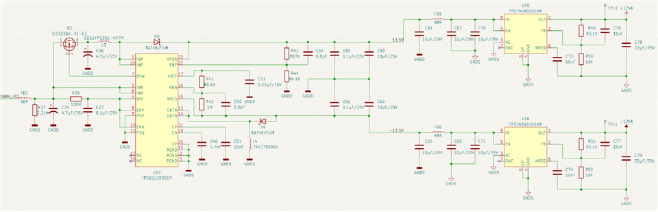

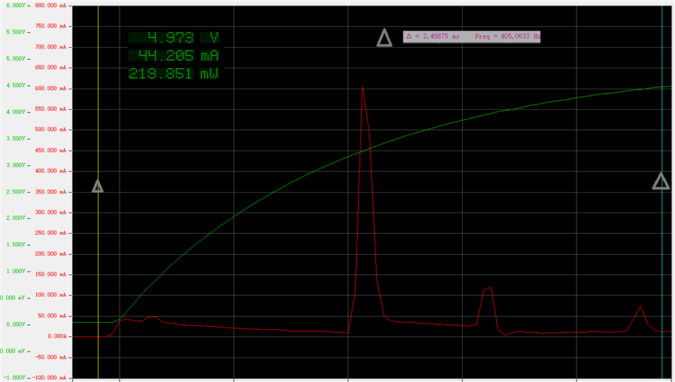

Hi experts,
In our application, we meet one surge issue during power-on stage with TPS65130, the sch. is attached, we capture the power-on voltage and current of TPS65130's input (USB5V_ISO). it has ~ 600mA surge current sinking from external USB5V_ISO side but in normal stage it only ~ 44mA current. could you please help suggest how we can reduce this surge current in our application? thanks.
