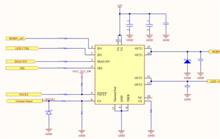

What is the maximum current can support each channel of TPS2H160-Q1?
As per datasheet Rds_ON is 160 mOhm.
But when I connected 2.1A load to one of the channel, Also,12V applied at VS  pin.  At output getting only 11.3V. (Ta = 24 Degree)
Ie, (12-11.3)/2.1= 0.333 Ohm.
What all factor effecting the RDS ON.
