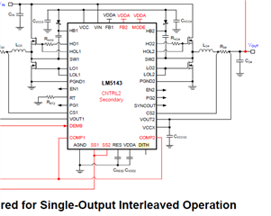

hi,
when 2 pcs of LM5143 are designed with multiple phase single output, how the secondary LM5143's DITH pin is connected?(in datasheet, DITH pin of 2rd LM5143 is float)?
hi,
Timothy
if the master LM5143's spread-spectrum is enabled, the spread-spectrum behavior can be found with 2rd LM5143 as SYNC signal from the master LM5143. Is it right?
