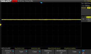

There are two images from my oscilloscope attached. One is the PWM signal from an ESP32, running at 20% duty cycle and 25kHz frequency. The peak voltage is 3.5V, so it meets the high-level voltage threshold for TPS92201ADRVR, and I already checked that the signal meets the minimum PWM on time requirement specified by the datasheet. The second is Vfb, it has a minimum of 80mV, mean of 233mV, and maximum of 640mV.
Additionally, varying the duty cycle of the PWM signal has no affect on the amount of current the device draws. My schematic is attached. I am using Rsense=125mOhms based on needing 800mA current at Vfb=100mV.

  • Hi Steven, thanks for all your input so far. For these measurements (as well as the previous waveforms) I am using the red channel. Attached is the SW waveform. The current through the inductor is 0.59A. In subsequent tests with duty cycles from 10-100% the current remained the same. I used 4V as the voltage input here. PWM duty cycle was set to 30%. Also, if this is relevant, I am using the standard 10uF capacitor/2.2uH inductor (part number SDER041H-2R2MS) as suggested by the datasheet.
  • Hi Max,
    The SW waveform looks unstable. Could you measure the VIN node and show me the oscilloscope capture (together with the SW waveform)?
    Steven

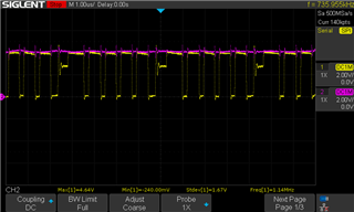

  • Hi Steven, attached are two images, one of just Vin and one of Vin with the SW waveform (I had to cut some traces to measure inductor current, so this is on the green channel if that matters at all). In the photo with two channels, purple is Vin and yellow is SW.
    I could definitely see how this could be problematic. I am using a cheap benchtop power supply to test these -- maybe the next step is finding a better quality power source?
  • Hi Max,
    The input power rail does not look good based on the above picture. Please add more input capacitors or use a power source with better quality and have a try.
