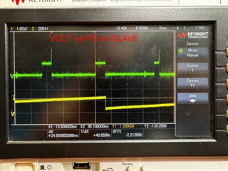

Supplied 12V. What is happening after powering up is that the bucks are buzzing. The output signal is a kind of a sawtooth going form 0,3V up to about 1,4V. I observed that when output voltage crosses 1V2 it pulls the PG on the SLAVE high. On the master the PG signal remains always 0.

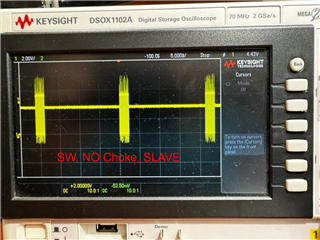

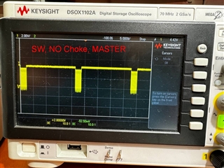

Just out of curiosity I desoldered both chokes to measure SW signal on both devices. Suprisingly they are somehow different.
On Master the SW signal oscillates around 4V and going from aprox -1V to +8V. While for the slave device it would also go with 4V line with the osccilations but ranging only form -1V to +3,8V. I have no idea why is there any difference - FYI as an observation.

Oscilloscope measures:

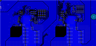

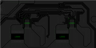

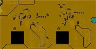

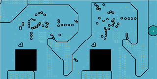

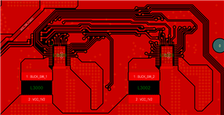

Layout:

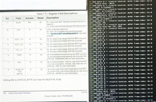

    Separatelly we ware able to read from the device and the result is as follows reporting bits 0, 5, 6, 9, 11 and 15 as "1" in (79h) STATUS_WORD Register.

    I’ve changed inductors from 1uH to 150nH that I borrowed from TPS546D24AEVM-2PH. Added 2x1000uF bulk capacitors on 1V2 output as well as 2x1000uF on the 12V input rail. The result is exactly the same. The converter ramps up the voltage, crosses the 1V2, pulls the PG high. Despite that it continues to go up with output voltage till about 1.45V. And than restarts the cycle. It restarts every ~9ms which is about 115Hz. And all that even without any load on the output.

    The status bits you are seeing are all indicating an output over-voltage (VOUT_OVF) which is likely a result of the problems with compensation compatibility with the inductors and output capacitors.

    Are all of the input and output bypass capacitors on the opposite side of the board from the TPS546D24A converters?
