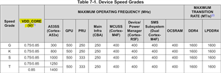

Hiii TI expert,
We have checked that both PMIC part TPS6521903RHB & TPS6521904RHBR can powered up SOC but there is difference is VDD_CORE voltage is which 0.75V & 0.85V respectively for this two PMIC. SO can you please confirm below points,
We have considered SOC part [MPN:- AM6254ATCGGAALW] in our design.
1. what is difference in operation or performance of SOC [AM6254ATCGGAALW] if we design power supply based on PMIC TPS6521903RHB & TPS6521904RHBR. Please explain as per SOC operation/performance point of view
2. We have used the PMIC Part (TPS6521903RHB) in our design so please check and confirm that Processor/SOC (AM6254ATCGGAALW) & PMIC (TPS6521903RHB) combination will work fine or is there any challenge?
