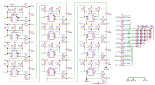

Wer developing a Board for 8s batterie balancing and charging.
We have the charging part working, but the balancing does not work in either autonomous or host-controlled mode.
All we want from this IC Is balancing, non of the protection features are of importance.

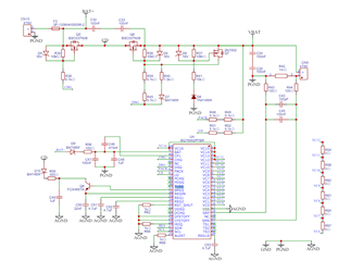

This is our Schematic
As you can see there's no alerts nor status bits.
All we need is balancing, I have a feeling that some register is not set up somewhere, can you please assist.
These bords have to go in production in about a week, would like to use this ic and not have to switch.

  • Hello Oskars,
    I do notice you actually have VC16 shorted to VC15.
    This device requires a real cell to be attached between VC16 and VC15. VC16 is used to power the cell balancing circuitry, so this may be affecting your balancing. Otherwise balancing should occur just fine (As long as there are no fault conditions preventing it from balancing).
    How cells are connected is explained in the following FAQ:
    To give a quick example of how to manually balance Cell 1:
    • W: 10 3E 83 00 01 00   - Set Cell 1 to be balanced
    • W: 10 60 7B 06             - Send checksum and length so cell balancing takes effect
    • W: 10 3E 83 00             - Write 0x83 to 3E and 0x00 to 3F (Writing 0x0083 to 3E/3F so that we can read from it)
    • R: 10 40 2                     - Read from 0x40 transfer buffer to confirm which cells is being balanced. (Should return 0x0001)

  • Thanks a lot Luis,
    Will rewire and try again.

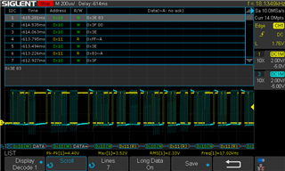

    I also probed the i2c communication during this write and read of 0x0083 with an oscilloscope.
    This is the result of the communication...
    I2C Time Address R/W Data
    1 -615.201ms 0x10 W 0x3E 83
    2 -614.535ms 0x10 W 0x3F 00

    35 -201.397ms 0x10 W 0x40
    36 -201.129ms 0x11 R 0x01 00
    37 -212.200us 0x10 W 0x3E 83
    38 437.200us 0x10 W 0x3F 00
    39 908.900us 0x10 W 0x3E
    40 1.17710ms 0x11 R 0xFF
    41 1.47810ms 0x10 W 0x3E
    42 1.74600ms 0x11 R 0x83
    43 2.04540ms 0x10 W 0x3F
    44 2.31450ms 0x11 R 0x00
    45 2.61290ms 0x10 W 0x40
    46 2.88110ms 0x11 R 0x01 00
    47 203.784ms 0x10 W 0x3E 83
    48 204.446ms 0x10 W 0x3F 00
    49 204.918ms 0x10 W 0x3E
    50 205.186ms 0x11 R 0xFF
    51 205.487ms 0x10 W 0x3E
    52 205.755ms 0x11 R 0x83
    53 206.054ms 0x10 W 0x3F
    54 206.322ms 0x11 R 0x00
    55 206.621ms 0x10 W 0x40
    56 206.889ms 0x11 R 0x01 00
    57 407.780ms 0x10 W 0x3E 83
    58 408.405ms 0x10 W 0x3F 00
    59 408.876ms 0x10 W 0x3E
    60 409.145ms 0x11 R 0xFF
    61 409.446ms 0x10 W 0x3E
    62 409.713ms 0x11 R 0x83
    63 410.013ms 0x10 W 0x3F
    64 410.282ms 0x11 R 0x00
    65 410.580ms 0x10 W 0x40
    66 410.848ms 0x11 R 0x01 00
    67 611.776ms 0x10 W 0x3E 83
    68 612.437ms 0x10 W 0x3F 00
    69 612.910ms 0x10 W 0x3E
    70 613.178ms 0x11 R 0xFF
    71 613.480ms 0x10 W 0x3E
    72 613.747ms 0x11 R 0x83
    73 614.047ms 0x10 W 0x3F
    74 614.315ms 0x11 R 0x00
    75 614.614ms 0x10 W 0x40
    76 614.883ms 0x11 R 0x00 00
    77 615.351ms 0x10 W 0x3E 83
    78 615.888ms 0x10 W 0x3F 00
    79 616.361ms 0x10 W 0x40 01
    80 616.832ms 0x10 W 0x41 00
    81 617.367ms 0x10 W 0x60 7B
    82 617.838ms 0x10 W 0x61 06
    Any idea of why is this so ?

  • Hello Oskars,
    You mentioned the following:
    "Also for some reason cell 16 is shown as 1.3v and cell 7 is 5.9v.
    The average of cell 7 and 8 roughly corresponds to those two cells put together."
    Which is a very important detail here. As I mentioned earlier, when there's a fault, cell balancing will occur, in here it seems that the voltage is going pretty low, likely triggering a CUV condition. That would cause balancing to stop completely. The CUV check occurs every second during cell balancing, so that's likely why it stops roughly every second after cell balancing starts.
    The cell behavior sounds like a hardware set-up issue. When one cell goes low and the other proportionally increases, it is likely to a high resistance on the cell input, caused by a poor wire connection or an open-wire condition to the VCx pins.
    I would double check all of the wirings here and make sure all is properly connected and where it should be. Ideally I would recommend to spin a new board with the correct connections, if possible.
