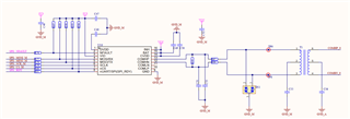

The above picture is the pulse timing of my wake up 600, the time is in line with the requirements, but the oscilloscope measurement in operation SpiWriteReg(0, CONTROL1, 0x20, 1, FRMWRT_SGL_W); //send wake tone to stack devices before RDY is lowered, according to the instructions in the user manual, RDY is lowered, the host write operation to 600 is invalid, would you please help TI engineers to find out the reason?

    Please confirm, you are successfully waking the device (if using an EVM, the green LED comes on, and on any BQ79600 the CVDD and DVDD are pulled up) and then sending a write command with nothing in between. This write command incorrectly has SPI_RDY forced low and it stays low (I see this in the images you've sent). It is possible this is a defective BQ79600 device.
    Additionally, is the end application automotive or ESS?
    Ben
  • Our application is ESS, BQ79600 is applied on the hardware board developed by ourselves. Do you mean that the command I send is wrong, which will cause SPI_RDY to be lowered? Is it not a question of wake-up timing? I seem to have noticed this as well, and I don't know if it has anything to do with the command "90 00 03 09 20 13 95", which is supposed to send wake tone to stack devices. I can parse this command correctly with an oscilloscope. How can I go wrong? I have blocked other commands to verify whether it is related to this command, and only this command interacts between MCU and 79600. Could you give some technical support for this phenomenon? Thank you!
  • Zhang,
    This issue is likely a defective BQ79600 device. I do not think your command is incorrect. I am going to hand you off to our ESS manager so we can do a customer return (you can start that process here).
    Ben
  • Hi Zhang,
    I'll be taking over from Ben on this support. Before we go through the process of ruling out this as a defective IC, let's go through some troubleshooting:
    1. Is the device completely unresponsive?
    2. Do you have an EVM you can use to compare your results on your own PCB design and SW, vs TI's EVMs and GUI?
    3. Is this a single unit or a consistent failure?
    4. How is your stack configured? I'm assuming the BQ79600 is your base, what's on the stack?
    5. Is the wake to the base working as expected?
    Arelis G. Guerrero
  • I do not have EVM as a comparison, how to configure stack, please take a look at the previous information, thank you!
  • Hi Zhang,
    2. Is this a single unit or a consistent failure?
    3. How is your stack configured? I'm assuming the BQ79600 is your base, what's on the stack?
    4. Is the wake to the base working as expected?
    Arelis G. Guerrero
