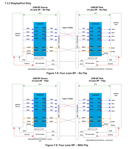

Can TUSB1044 redrive DP signal? Thanks!

Yes it can as shown below,
For DP re-driver, you can also consider DP141, DP142, or TDP2004.
