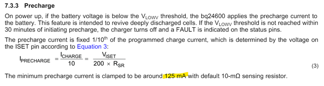

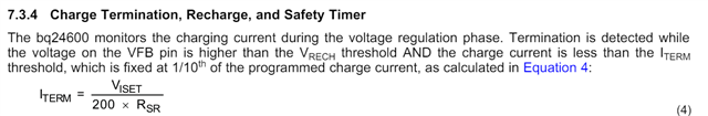

Is it correct that if the charging current (Iset) is set to 800 mA, the termination current will be 80 mA?
I would like to inquire because the minimum value of the precharge current is 125ma.

Hello David,
Yes, This is correct.
Christian.

Regardless of the below, it's terminated at 80mA, right?
Hello David,
I'm sorry for the confusion.
Yes, the termination current is also clamped at around 125mA. I confirmed this on an EVM.
