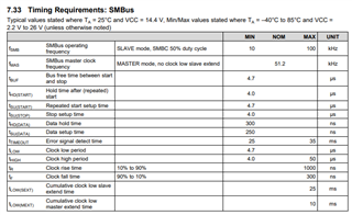

    Can you please tell us how the gauge is being communicated to whether it be EV2400 or a custom MCU? If a custom MCU is being used, can you please confirm whether the MCU supports clock stretching?

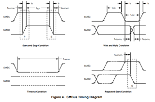

    Regarding the packet structure, has the rate that the commands being sent at been attempted to be slowed down to see if there was any difference in the result?
    Also, after the three seconds of the good readings, are there any breaks in the structure of the commands seen below?

    the communication protocol looks exactly like in the diagram you sent, after 3s,
    it changes and the communication gets scrambled.

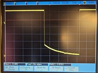

    I see above that it is stated that the DSG FET closes at this time, however where is this voltage drop being measured? Or is this based on the reading from the gauge at this time?
    Anthony Baldinoo
  • Dear Anthony,
    we measure the voltage drop on the battery output via scope.
    you can see the 780ms drop.
    seems a bit fast for protection and too long for hardware short circuit / AOLD.
    this is why we suspect the chip is crashing at rebooting.
    Ran
