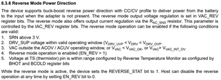

It looks like the UVLO has a min of 4.2V which is not suitable for single cell designs.
I thought this part could do that?
If I put a power supply in place of the battery at set it to 5V, the reverse mode works.
In addition the DRV_SUP has to be set to >4V.
Hello Dante,
Reverse mode should be able to work when the battery voltage is above 3V. You can find the checklist for reverse mode to work in section of 8.3.6. I've posted a screenshot of the datasheet below.

Hi Ethan,
Here is what I found in the datasheet.
This is verified on the bench. If the battery is less than this reverse mode does not work
Also, the DRV_SUP must be >4V.

Hello Dante,
The BQ25756 will need a minimum of 3.8V to start reverse mode. Reverse mode should stop working at 3V. Sorry for the miscommunication.

Hi Ethan,
Based upon work I did on the bench and specs in the datasheet can you please confirm.
DRV_SUP must be > 4V
UVLO must be > 4.2V
This makes usage with a single cell Li battery problematic unless DRV_SUP and UVLO are powered from something other than
the battery, this is because the battery voltage can range from 3.5V to 4.2V

Ethan,
I just discovered when I select reverse mode on the eval kit it will not work unless the battery voltage is
over 4.2V or so.
For this test I had DRV_SUP = 5V and ACUV = 5V.
So, the reverse voltage will only turn on if the voltage at the battery terminals is 4.2V or higher.
Dan
Hello Dante,
UVLO and VVAC_OK only apply to the converter operating in forward mode.
In the lab, I'm able to measure reverse operating at a minimum voltage of 3.8V. Are you using the BQ25756E EVM for these tests?

Hi Ethan,
Thanks for the response.
Yes in reverse mode maybe 3.8V on the battery will work, unfortunately that is not good enough for a 1 cell Li battery.
That type of battery can get down to 3.5V or so and then reverse mode will not work.
I found I can boot-strap the reverse mode operation by using a diode to OR in 5V onto the battery line for 100ms or so and then disconnect it.

I requested an email address from you to continue this discussion.
The most important thing right now is to understand why the datasheet says the battery needs to be
greater than 3V (pg 23 and many other places in the datasheet to engage reverse mode), yet on the bench
I need to set the battery voltage to >3.8V to get the eval board into reverse mode.
Is the datasheet incorrect??
Please respond ASAP.....things are getting critical.
Dan
Hello Dante,
Yes, the datasheet is incorrect and we are working to correct this on the datasheet. I should have been more clear on this in my response.
Comments?
That should work. Keep in mind that the voltage difference between the SRN and SRP pins should not be more than 0.3V.
