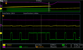

Design works principle ok. However, when supplied with lab supply with current limit set point at 3A so well below the current limit of the DUT (5A) then we have the issue that the PSU cannot normally start since input voltage drops. This behaviour is ok. The issue is that for some units the power components fail (low side switch MOSFET) as well as PWM controller (LM5122).PWM controller failure mode and effects seems to be different. Sometimes there is a short between SW node to AGND. Another effect is the short of VCC pin to ground.
I have measured startup for this scenario (Vin=20V, 3A current limit set point) and seen that sometimes the Low side ON time is quite long, which I don't understand (see screenshots below)
First complete sequence from power-up until first switch if UVLO threshold reached due to too low current limit set point of feeding supply..
Next figure: the detail for normal switching. It shall be noted that the pulse width increases with time
The next figure: detail with unusal long pulse width:
Please note I have switched off channel 3 for the detailed screenshoots (2-3) in order to focus on the most important signals.
First of all the period time is longer than normally, Second there is a short Off-pulse. Input voltage at this zoom area has not dropped. Actually under this scenario I could not catch a damage case. Nevertheless I have the following questions:

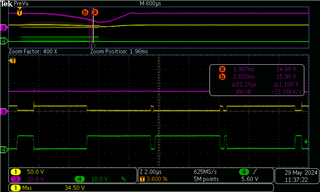

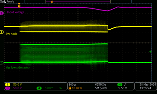

    Could you make a zoomed in waveform measurement of the SW signal during start-up, so we can see how high the SW voltage is going?
    If there are strong overshoots on the pin, (especially if we see different LO pulse lengths,) it might be possible abs max is violated here.
    This would explain shorts at SW or VCC pin.

    Regarding switch node voltage. According my measurements the switch node voltage has never reached or exceeded the maximum rating of 105V so far. But actually I could not catch a new damage case for MOSFETs or the PWM controller.

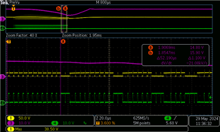

    The screenshots provided show the time directly after power up (trigger at rising edge in single shot mode). Below you find new measurements.
    1) Overview with signal to channel assignment info
    2) Zoom area 1 to see a number of long pulses

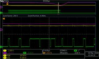

    3) Zoom area 2 with detail to one long pulse sequence
    So basically if this is normal behaviour of the LM5122 then we have somehow to cope with.
    If I can support with further measurements, please let me know. I have to understand waht is going on there. The Low side MOSFET may get overstressed due to this pulsing bahaviour (?!)

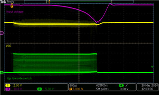

  • Hello Niklas,

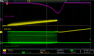

    thanks for your reply and the information. I have measured voltage at Soft start pin, VCC and COMP as proposed by you. I had to measure several times due to switching noise with standard passive probes. With the presented scope screenshots I have used very short GND lead (spring) for channel 1. There is still coupled switching noise but I could not get it better. The scope setup is always the same only channel 1 signal assignment changed during tests.
    1) Overview with captured soft start (ch1: softstart, ch3: input voltage, ch4: Vgs of low side switch)
    2) Zoom to detail with long pulse - softstart

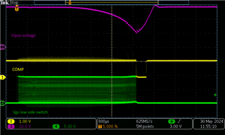

    3) Overview with captured COMP signal (ch1: COMP, ch3: input voltage, ch4: Vgs of low side switch)
    4) Zoom to detail with long pulse - COMP

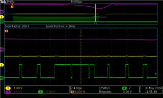

    5) Overview with captured VCC (LM5122 pin 19) signal (ch1: VCC, ch3: input voltage, ch4: Vgs of low side switch)
    6) Zoom to detail with long pulse - VCC pin of LM5122
    I don't see any issues with the signals here. VCC is always still in range if the long pulse occurs. Also the COMP and the soft start pin signals seems to be ok from my perspective. Do you agree?

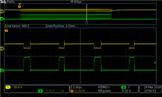

    I have checked my calculations and this long pulse sequence seems to generate very high currents in Low side switch. If you consider the last picture with the three succeeding long pulses this is a total length of ca. 10us. We are using 47uH choke for booster. The input voltage is about 17 - 18V, where this strange pulse sequence happen. I calulate a current of:
    dI=L x Vin / t(on) = 47uH x 18V / 10us => ca. 84A! For sure, there are the forced Off pulses with 330ns length each. However, the short OFF pulses will only slighly discharge inductor so current is only a bit decaying during the short OFF pulses. So the final inductor current may have a more relaxed final value.
    The used MOSFETs of type BSC250N10 may get overstressed if several long pulses occur in a sequence. Actually I have in my prototype design a BSC160N10, which has much better data.
    Any comment / correction regarding my analysis?
