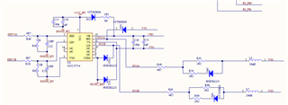

    1) Can you share the schematic as well as waveform captures of this?

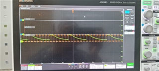

  • 1. Schematic of gate drive circuit and gate drive waveforms are shared. The Green trace is of high side drive, Low side drive is perfectly fine.
    2. This is the first time I am seeing this kind of issue, Other boards are perfectly fine.
    3. MOSFETS won't fail as we are only checking gate drive, we are giving 0 DC voltage, juts powered up the drive.
    4. Your 4th point may be the real cause, But I need to know what is going wrong with the IC.
  • Hey Faraz,
    1. Is the measurement on Channel 4 done with a differential probe from HO-HS? If not, that would be helpful to see what the Vgs of the FET is.
    2. Also, can you take a measurement of HS-VSS to see what the switch node is doing in this state?
    3. What is the output stage and the status of HS during this instance? If HS is floating with no output, the high-side will not pull down to ground.
    4. Also, what is the 20uH inductor on LO and HO for? That should not be there.
