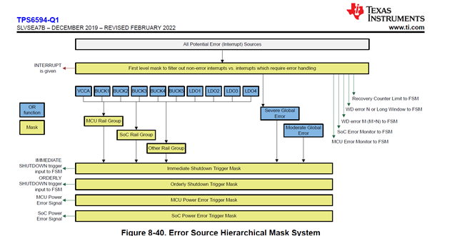

Hello, TI experts
Since we have done many things but all the rails never turned on.
When we take off TDA4VM from the board, all the rails turn on.
I want continue to discuss about the link below with new thread tile of TPS6594-Q1.
https://e2e.ti.com/support/processors-group/processors/f/processors-forum/1358810/sk-tda4vm-please-confirm-2-pmic-parts
I have detected several interrupts in our target board which is designed based on SK-TDA4VM,
(3-Phase DUAL PMIC PDN) (TPS65941213RWERQ1+TPS659411 on target board.)
I have tried to search for 2 and a half weeks but yet we don't know which caused these interrupts.
Q1)
The diagram below shows SoC power rail and MCU power rail are grouped together.
 Do they separated rails or tied together?  If separated, could you specify Soc Power rail and MCU power rail in SK-TDA4VM?
Q2) Could you let me know meaning of the interrupt and error which we dumped our board?
(Our target board doesn't power up so far)

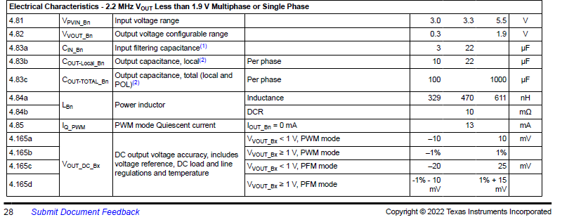

  • Jaecheon,
    after looking at the schematic, before changing the capacitors, please take a scope capture.
    But it looks like it's right on edge on the Cout-total capacitance,
    With the minimum is 100uF and the load capacitance (after the ferrite beads) is ~51.1uF and with only 47uF at the local & the DNI for the second 47uF. It would place you right under the minimum with 98.1uF assuming no variance. Something else to keep in mind, that this is after derating has been taken in to account. With a 25% derating and adding the DNI at the local BUCK5 output, would sett the Couttotal to ~108uF

  • Q1)
    The diagram is from the generic PMIC data sheet. It is just to highlight the different rail group options and how they could trigger faults. To know the specific rail groupings please refer to Table 5-7 in the user guide: https://www.ti.com/lit/pdf/slvuc99

  • It would place you right under the minimum with 98.1uF assuming no variance
    Thanks for advise.
    Unfortunately this sample board that I shared interrupts in this thread is no more exist since my boss took off TDA4VM away from the board.
    So I cannot o-scope here. But I will keep in mind when BUCK5 UV occurred. I have done installing only 22uF, 0uF(DNI all caps) or 94uF after bead on the rail of BUCK5, but I haven't tried over 100uF.
    Cout-total from 100 to 1000uF is recommended for every BUCK rail?
  • Cout-total from 100 to 1000uF is recommended for every BUCK rail?
    For this specific inductor and switching frequency use case that is correct.
