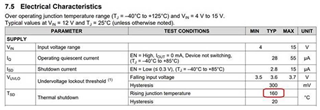

Could you let me know the minimum value of Thermal Shutdown (Rising junction temperature=160℃(Hysteresis20℃))?
When my customer's system is operating, TPS62180YZFR suddenly output PG=low and the output voltage goes down.
When the behavior above occurs, the customer's system temperature around TPS62180YZFR is ~130℃.
So it does't match 160℃ specified in the datasheet.
They would like to check the possibility to shutdown in the temperature lower than 160℃.
