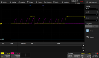

    We have made 24 nos. of board for initial prototyping and validation purpose, but in only 5 boards , we are having this issue not in all boards. But if it occurs how we should identify and try to resolve.
    The device address we have written is correct.
    Below are the scope snippets for the board which doesnt have this once and one which has the issue.

  • Hello Varij,
    Do you have any schematic for this design? The rise time seems pretty slow, is the RC constant high? is it possible to decrease the capacitance/resistance here?
    Maybe a smaller pull-up resistor for SCL/SDA.

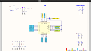

    Please find the below image of the schematic of AFE section as well as MCU.

  • Hello Varij,
    For now could you attempt doing both of these things and see if it improves things? The RC constant seems very long, so I am concerned this may be affecting the signal integrity between the devices.
    From the schematic I cannot tell any problems, but do try decreasing the pull-ups to maybe 4-kOhm and see if it improves this. And if not, try performing the ABA swap (Good IC to bad board, Bad IC to known good board) and see if the problem is reproduceable on either.

  • Hi Luis,
    As suggested by you performing the ABA swap (Good IC to bad board, Bad IC to known good board). We have noticed that both the boards started working.
    But its little bit weird.

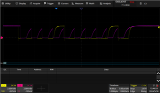

    In previous scope snippets, I believe it was probe issue we didn't receive better waveforms. But hereby attaching the new waveform with 10k pullup.
    I have replaced the pull up with 4.7k and then cross verified the rise time. It was approximate same.
    Looking forward to doing more trials and suggestion in order to find the exact issue.

  • Hello Varij,
    Sorry for the wait here! Just got back Slight smile.
    If the swap fixed it, could it have been that there was a poor solder connection in the I2C lines? The first scope shots shared definitely looked like the RC constant was very large. If the solder was not great, maybe it increases the RC due to parasitic resistance/capacitance. I'd advice to check continuity on the board.
    It is likely that the long RC was almost surely affecting communications, this new scope shoot looks a lot better. When the parts were swapped, they were essentially being re-soldered, so it is possible that there was a better solder done on the IC connections this time, causing the problem to go away.
    I would recommend to place a non-good board into the reflow oven to see if the device starts working as intended.
