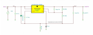

hi team
i use TPS7A33 to design a high minus power filter via float its ground. Vin = -50V, output -48V.
in circuit battery only set to 0, it works. set +/-V will not work. why?
please help.
hi team
please help.
Sorry for the delay in response.
The model does not work because the circuit inside is ground-referenced, so floating the GND pin is not possible since it is already grounded. I can't alter the TINA model because I don't have access to its design files. I could attempt to alter the netlist to float the ground if that would be helpful.
