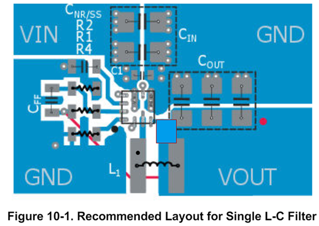

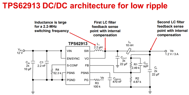

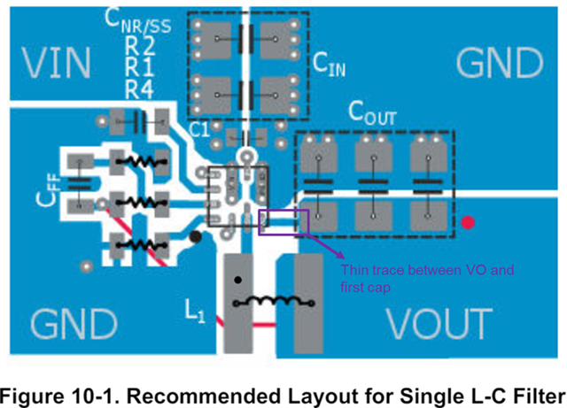

Hello Team,
the EVM shows a thin trace from VO-pin to Vout. According TPS62913 data sheet VO needs to be connected directly after the first inductor. But to measure Vout it should be connected to the last capacitor, close to Vout?
I guess VO-pin is high impedance and susceptible for noise, correct? Or is there any other consideration?
Thank you and Best Regards,
Hans
