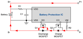

I would like to know if the TPS1210-Q1 can drive two MOSFETs on the ground line as shown in the image below.
Thank you in advance,
Hi Khalil,
Yes, TPS1210-Q1 can be used to drive FETs on low-side.
they prefer openning the Battery(-) for safety reasons
Rakesh-> Can we know why ? usually we see disconnecting switches on Battery(+) line
