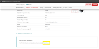

    We have our TPS3762-Q1 (ASIL-D functional safety compliant wide Vin supervisor) that has all of the functional safety calculations provided (FMEDA, functional safety analysis report, safety manual, and safety report). This information can be requested on the product folder:

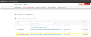

    We also have a functional safety capable device the TPS3760-Q1, more specifically the overvoltage OPN is TPS3760E012DYYRQ1. This device provides functional safety FIT rate, FMD, and FMA functional safety documentation. This information is available in the product folder under technical documentation:
